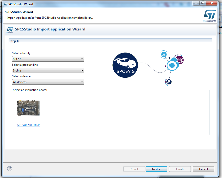

We have the SPC570S-DISP board which has the SPC570S50E1 MCU. The SPC5Studio Import application Wizard only has SPC570S50L1DISP for the SPC57 S-Line.

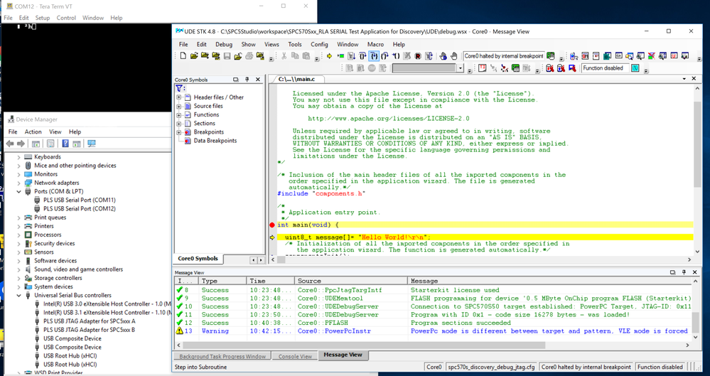

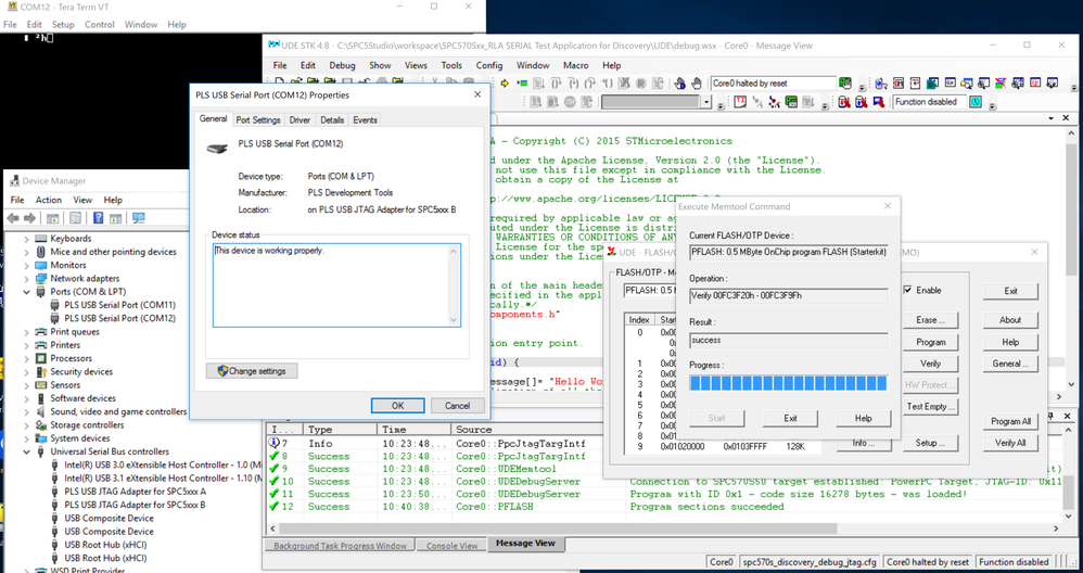

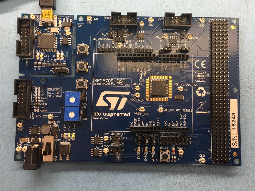

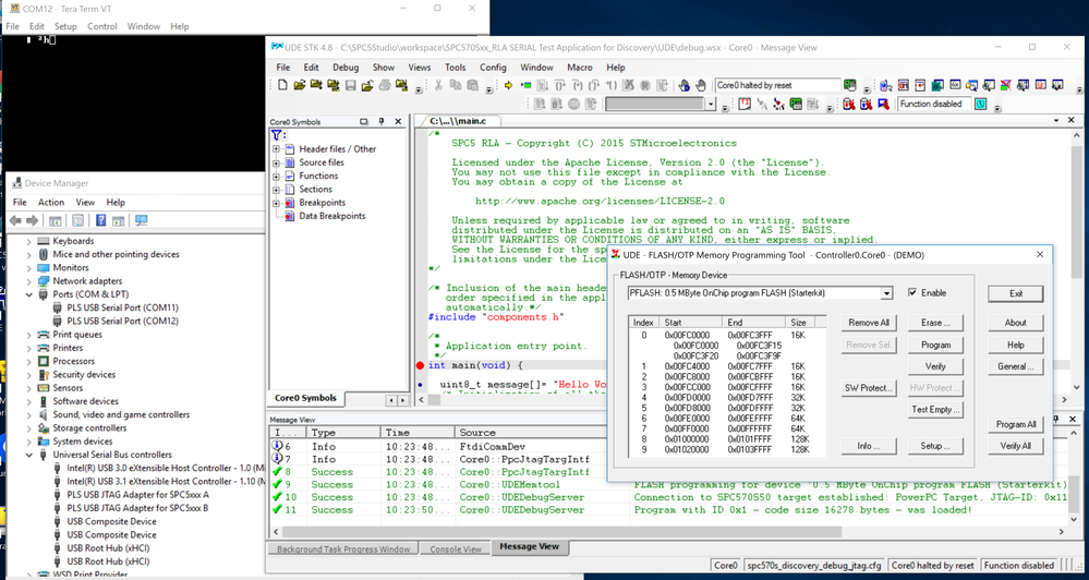

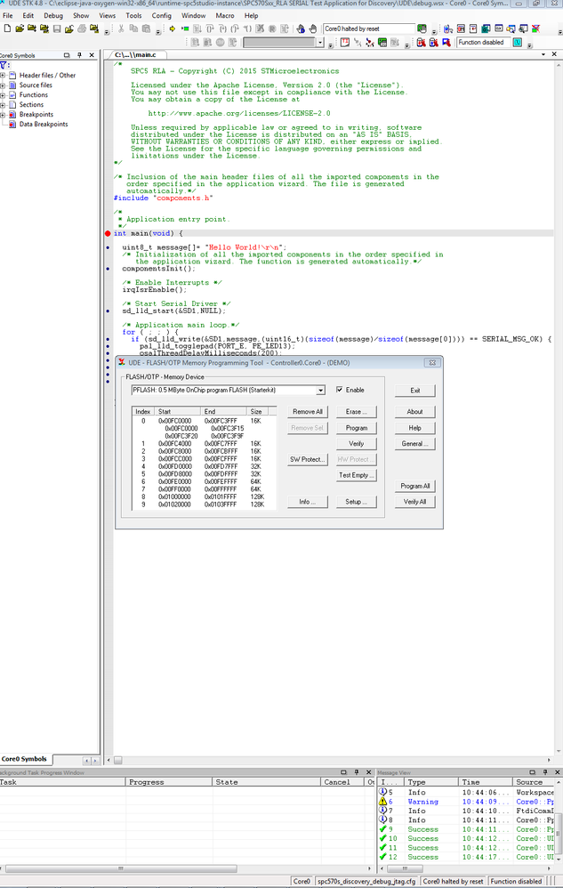

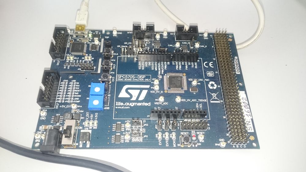

I uploaded 4 images.
1 - application with USB port names
2 - program board ok and com port info
3 - step in caused warning - ''powerpc mode is different between target and pattern''
4 - my board

2017-11-30 12:41 AM
Hello Job ,
According to your screenshot, all is ok.
Your program is halted by an internal breakpoint.
you should click on Go to continue the program.
the warning :
'powerpc mode is different between target and pattern VLE is forced' is normal.
Anyway, all the program on SPC56,SPC57 are compiled in VLE mode.

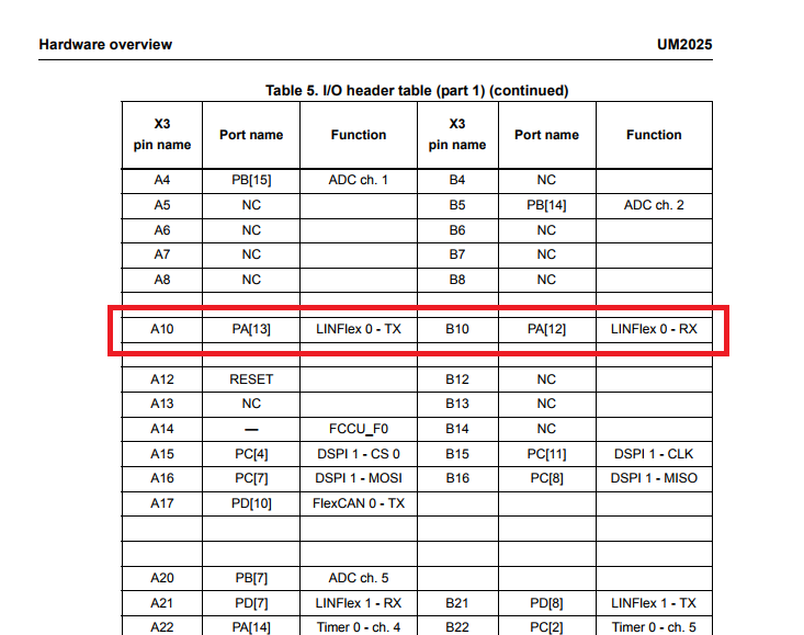

Plugged on LINFLEX0
Honestly , for your requirment
there are 2 choices ,
1) Use the GPIO LINFLEX0 (it is the same)
A10 and B10 cf Document SPC57S-DISP
Same strategy as :

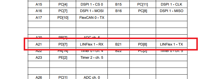

2) Configure LINFLEX1 , and plugged into LINTX1 , LINRX1 an other Serial Module (A21 and B21)
I will choose, HC06 and use the BT serial in order to Communicate with your Raspberry PI 3

Thank you for looking into my issue. I have got it working now. If i could have a photo of my setup, that would be much simple, but office policy.
I have mini USB connected between my PC and SPC570S-DISP, the USB provide power and also provide debug to the board. I connect the SPC570S-DISP through 3 jump cables, actually i only needed 2, one for GND and one to connect the TX from board (Raspberry Pi 3 only used to received data).
I had ST support notified me that in order for the second COM port to work, the PIN 3,4 of JP1, PIN 3,4 of JP4 need to be connected, i did that and it worked, the same data are printed on my COM12. Menawhile I also have jumper cables between Raspberry Pi 3 and the board, i found same data is available on TX/D1 of P5 and C11.
