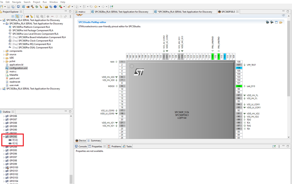

Hi Technical team.
I want to configure both F12 and F13 as input pin.
When i am trying to configure F12 and F13 as input pin in PinMap Editor , it gives error (attached the error screen).
I tried this on sample project "SPC560Pxx_RLA SERIAL Test Application for Discovery".
Hardware used : SPC560P Disp
Please suggest me your ideas to solve this issue

Erwan YVIN
Hello Ratheesh ,
Cf reference manual,
It is not possible to configure F12 and F13 with the same function (Ex: GPIO92).
Best regards
Erwan

Erwan YVIN
Yes ,
You have tried to configure F[12] and F[13] to the same GPIO
cf Screenshot and reference manual
Best Regards
Erwan

Erwan YVIN
Hello Ratheesh ,
Best regards
Erwan
