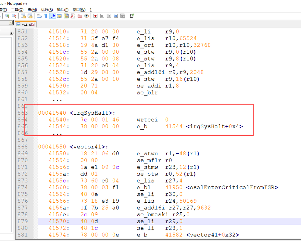

After jumping, it will enter the loop code?The value of the PC register is 0x00041544
So I entered the command at the terminal:
ppc-freevle-eabi-objdump.exe -S out.s
what should I do?

I think that you are going to  SPC5_CLOCK_FAILURE_HOOK();

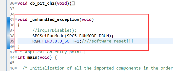

so I am going to modify the irqSysHalt function:
void irqSysHalt(void) {
irqIsrDisable();
SPCSetRunMode(SPC5_RUNMODE_DRUN);
RGM.FERD.B.D_SOFT=1;  //software reset ???
for ( ; ; ) {
But the MCU did not restart...How to do it?
Posted on June 20, 2017 at 16:01
I should add ''soft reset'' to _unhandled_exception:
Before modify wrong..............................
