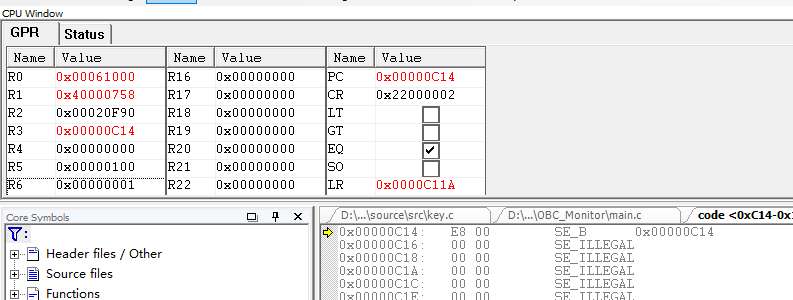

Posted on June 13, 2018 at 06:02
Hello Erwan?
   I checked the PC pointer?and found that when I jumped from application program to bootloader FUNC which been located at 0x8000?the PC pointer was missing at the init FUNC? and I press the ?break? button ?the PC was always at the 0x00000C14?which is the vector address?but the R14 is always 0x00000000?the init FUNC is library function. Why could this happen?
