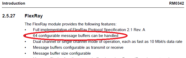

2022-05-17 6:59 AM
I suppose you still working on SPC56xL70 so the reference manual is RM0342
you can see in Table 327. FlexRay memory map (Sheet 1 of 4):
there are not 32 but 64 slots of these registers MBCCSR/MBCCFR/MBFIDR/MBIDRX
Best regards.

Concerning the number of buffers, the document is clear:
there are 64, no more
