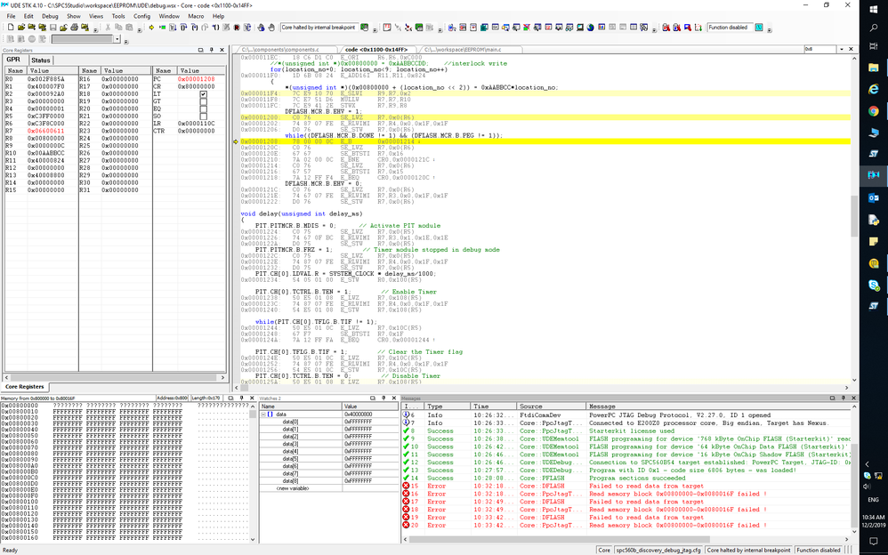

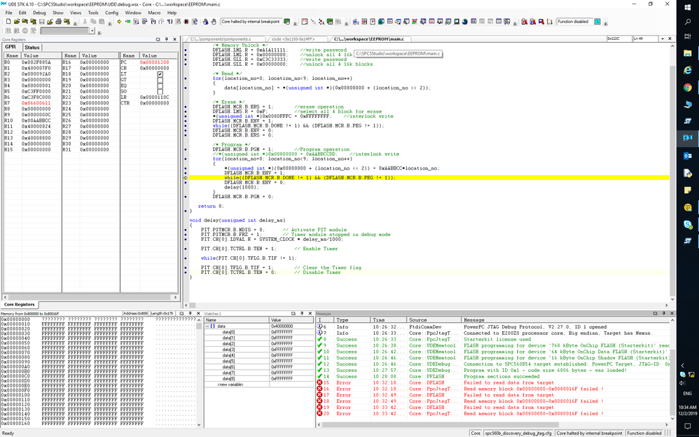

When I am trying to write word by word to multiple locations, while writing 4th word, an error is occured.. READ MEMORY BLOCK FAILED. However, next 5 locations are written successfully.
Screenshot is attached below.
I am looking forward for the reply.
Thanks and Regards,
Pooja WANI

Some screenshots from PLS UDE window are attached herewith. Please help me to find out the solution. I am blocked here since last two weeks.
Thank you.
