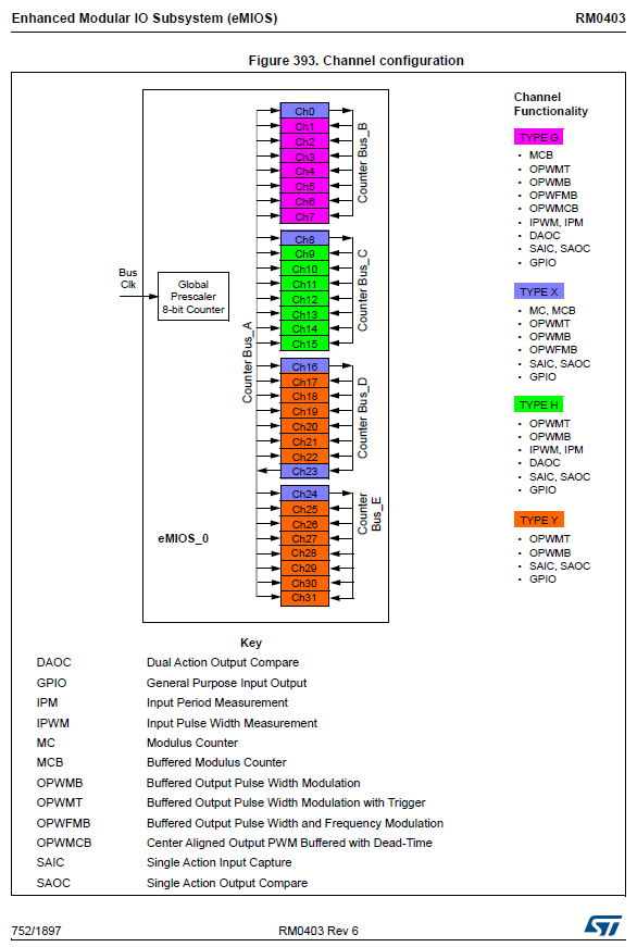

Nevertheless, it is not easy to comprehend, which group and channel number in the SPC5Studio Low Level Driver Wizard corresponds to the UC0-UC31 pins of the processor. According to RM0403 on page 752, the different channels support different modes.
Here as a picture for easy reference:
So far so good. That's why I planned using pins UC13,UC14 and UC15 as IPWM inputs and using UC16 as OPWFMB.
In the configuration wizard groups 1-3 only allow OPWMB or OPWMT mode. And on the group 0 channels, IPWM is not a selectable option.

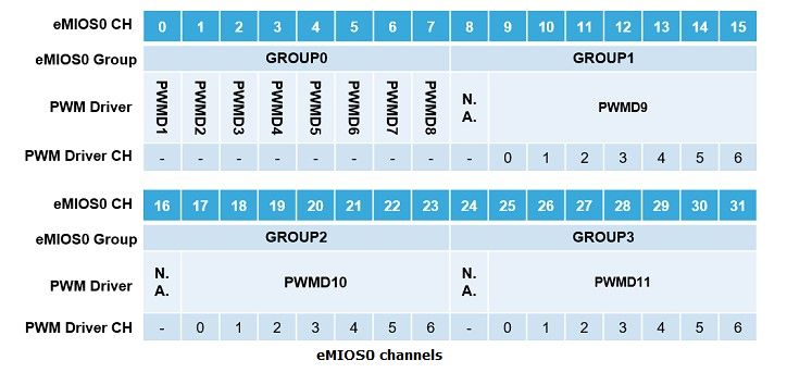

the relation between the eMIOS channels and the PWM low level driver channels is summarizing in the pictures that you can find in the document contained in the folder spc582bxx_low_level_drivers_component_rla/doc within your SPC5Studio test application.
As you can see from the picture, the eMIOS channels 8, 16 and 24 are not available (because there are used as counter for the other channels within the same group). In the current version of the driver for the channels of Group 1, 2 and 3 only the modes OPWMB and OPWMT are supported. Instead, for the channels of the Group0 only the modes OPWFMB (PWM) or SAIC (ICU) are supported.
