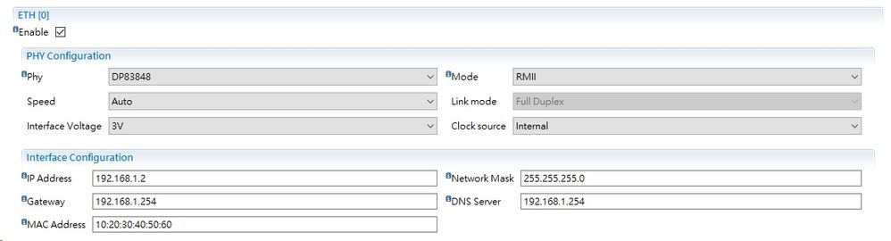

I have SPC58EC-DISP,
now I use sample code(Network Gateway Test),it's MII mode and working;
then,I want to use RMII mode,I set PHY MODE = RMII,it's not working,
how to do it?
ps:The OSC is changed to 50MHz,and SB5 Close & SB6 Open.

I have the same problem with a SPC58NG-DISP :
On SPC58NG-DISP , there are 3 shunts : MII/RMII , 25/50 MHz , TXCLK
With this modification :
But Ping doesn't work.

Great,I can works too,
for the network gateway, 1 modification must be add:
1) add the Oscillator 50 MHz pin to TX_CLK.
