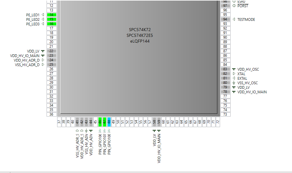

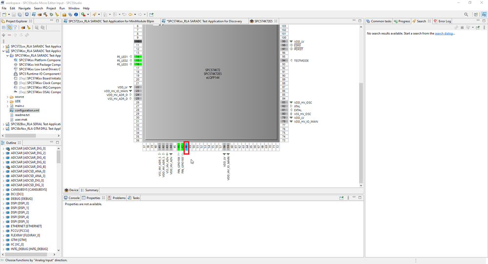

SARADC has been configured for PIN_GPIO106 and PIN_GPIO107 not able to configure for PIN_GPIO108
Gui configuration has been changed , SARADC channel has been enabled and Pin function has been set.

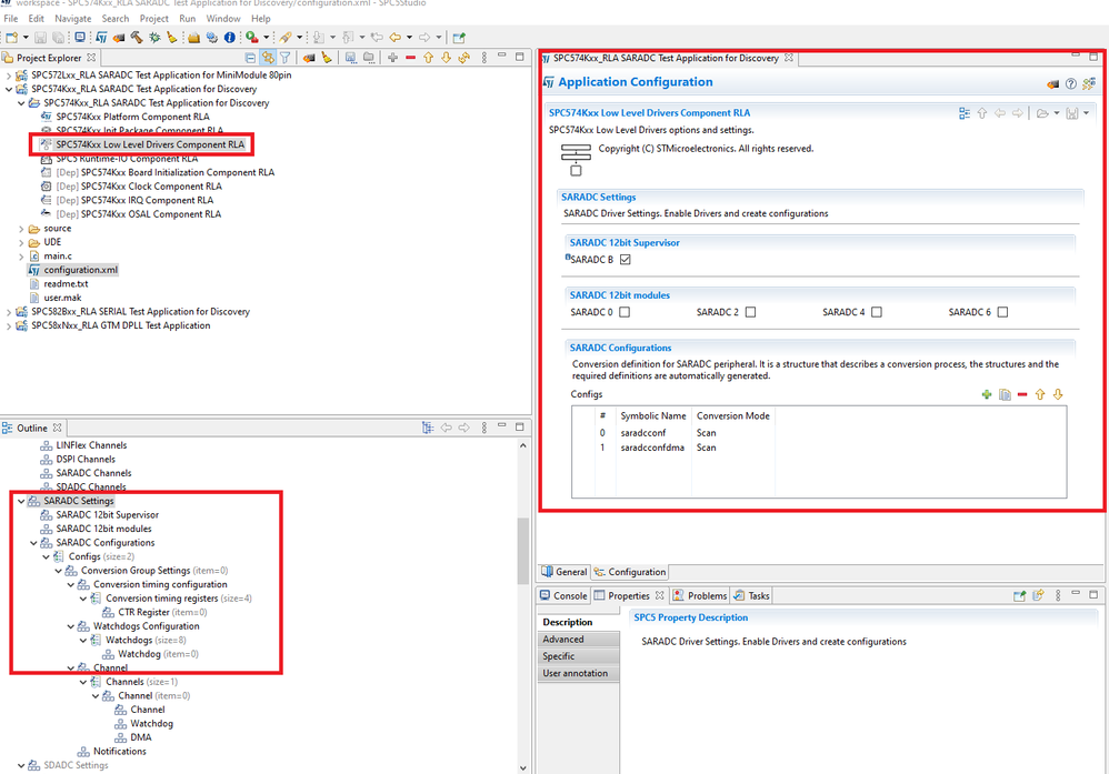

you can set the PIN48 for ADC and update ADC low level drivers in configuration
Best Regards
