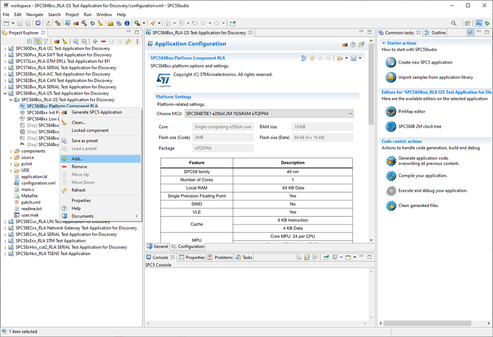

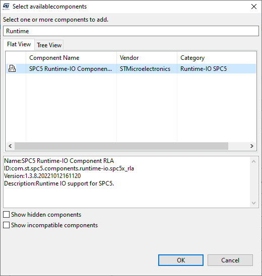

Select a Platform Component (right click)
0693W00000WIn3NQAT.pngThen select Runtime I/O component
Hi Giuseppe DI-GIORE,
Thanks you for your reply. I can add this ​"Runtime I/O" component to my project.

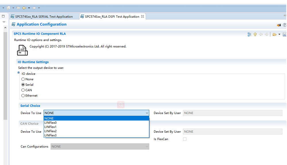

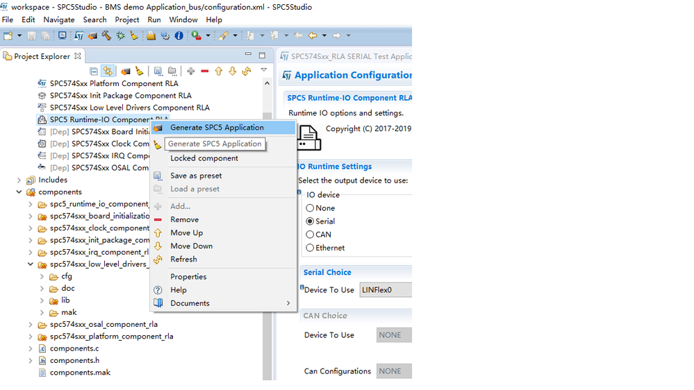

Then I need to select Linflex1 to use like picture. I use SPC574S64E3, I want to use PIN81 and PIN 82 to output data, so what should I do next? I tried to right click on "SPC5 Runtime -component" then select "Generate SPC5 application", it will show an error. attached picture for your reference.
Giuseppe DI-GIORE
Configure the serial port using the Low/Level Driver component (selecting the pin you need) and the select the just configured serial port in the Runtime I/O component.
