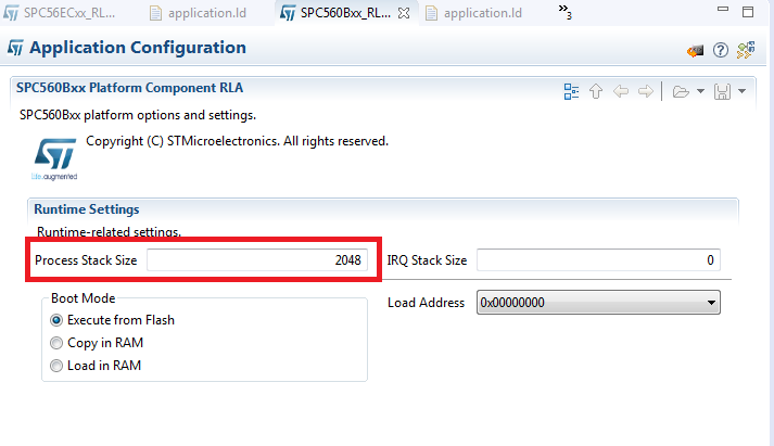

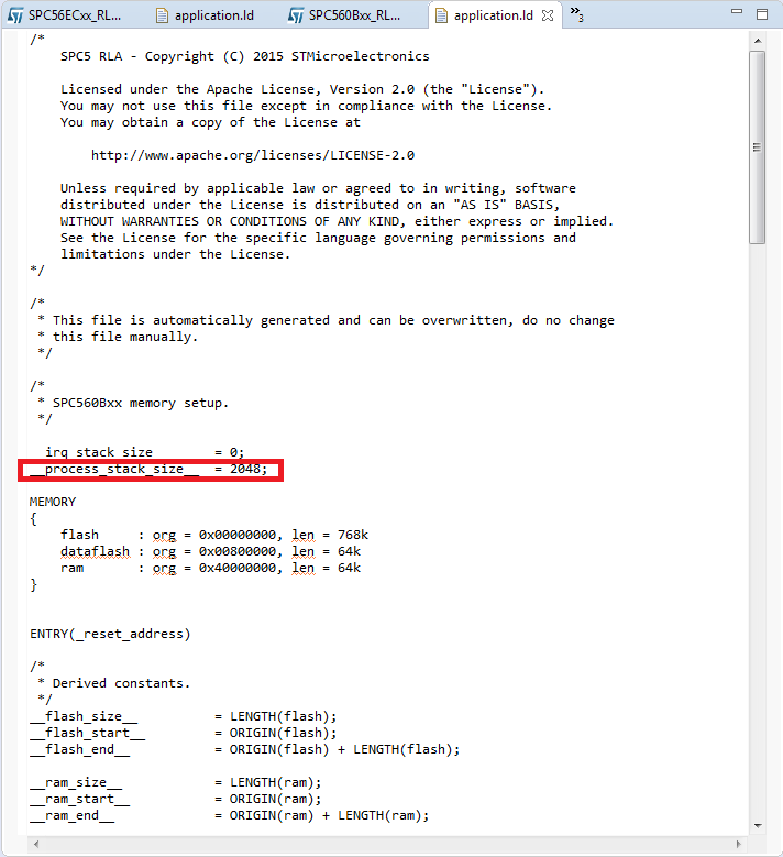

Hello Thomas ,
in SPC5Studio, rename application.ld by user.ld
and you can customize your stack size by updating this following value
Best Regards
Erwan
