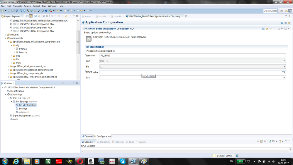

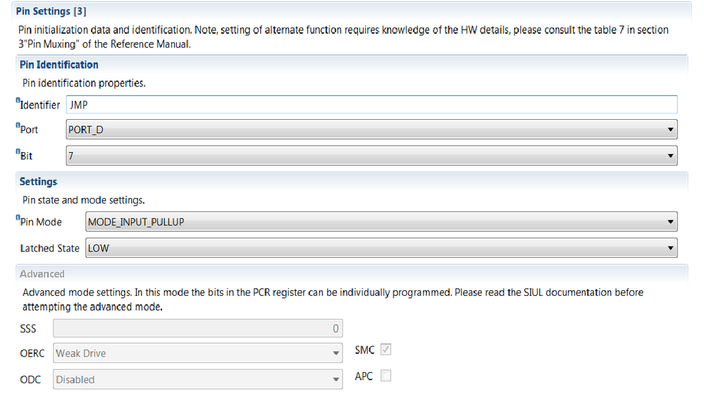

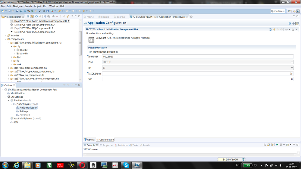

After updating SPC5Studio to ver 5.5 I have a problem with Pin map configurations. Selection of the port and the pin are both not enabled.  You can see in the pictures the previous version, and 5.5.0690X00000608HdQAI.png0690X00000608HYQAY.png
What could be the reason?

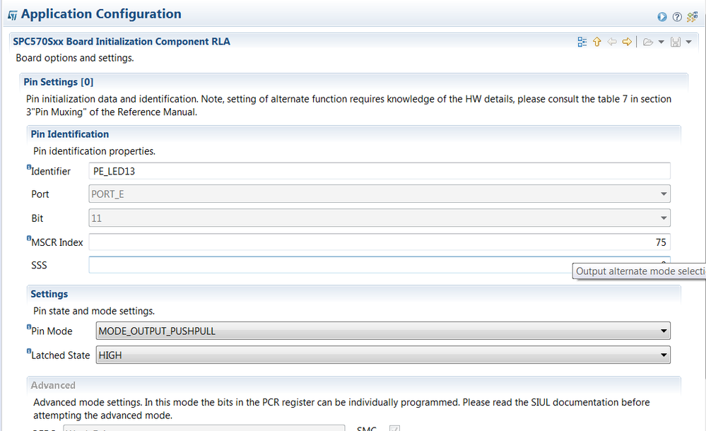

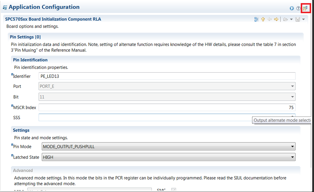

Erwan YVIN
Posted on September 19, 2017 at 16:22
Hello Yuri ,
You should click on Advanced Mode

Yuri Nagornii
Associate
Posted on September 20, 2017 at 09:34
Erwan.
But there isn't a difference.
