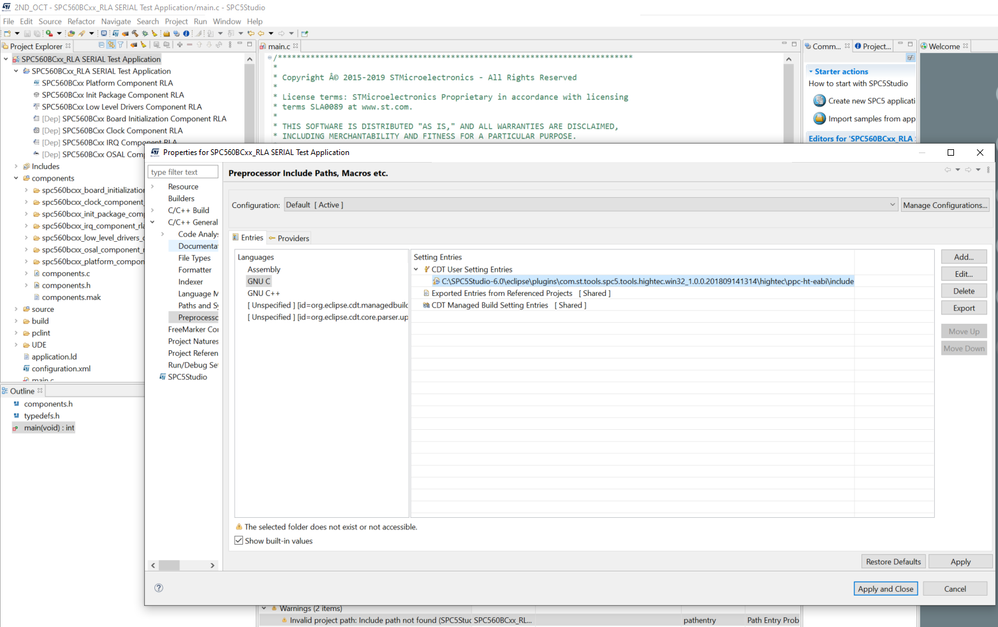

Yes ,
It is not a big issue.
Your CDT settings is not updated maybe after importing an old application.
directory does not exist anymore and preprocessing is failing.
you can update it by add a new directory which contains include files
c:\SPC5Studio-6.0\eclipse\plugins\com.st.tools.spc5.tools.gnu.gcc.ppcvle.win32_4.9.4.20201012092103\toolchain\powerpc-eabivle\include\
or
c:\SPC5Studio-6.0\eclipse\plugins\com.st.tools.spc5.tools.hightec.win32_1.0.0.20201012092211\hightec\ppc-ht-eabi\include\
Take your good qualifier date
Best regards
Erwan
