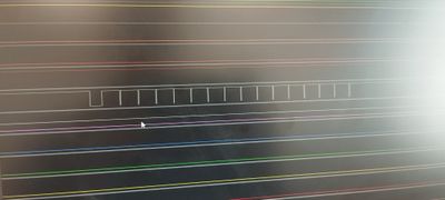

I'm working with SPC560P40 and I tried to send CAN data but with any condition which I tried out, it has just some regular pulses that has no meaning. I saw all examples in SPC5Studio but I got same pulses. would you please help me out with this problem.

Hello
Thanks for your quick response, I tried out these codes and configures but the issues is still remaining. About the timing, based on formula for Bit Rate in this section, I tried to set the Bit Rate to 500kbs as the SYS_CLK is 64 MHz and XOSC_CLK is 16 MHz, how should I set PROPSEG, PSEG1, PSEG2 AND PRESDIV?

Hello
Actually I tried them but it still has meaning less signals. Then I checked out board initialization component parts and pin identifier, I saw it has warning and says pin name must be unique! So would you please help me out with this.
