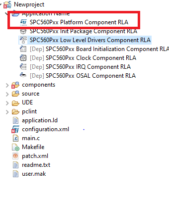

Iam saravanan working as Embedded software developer at iELEKTRON Technologies
We are kick start our BLDC driver development project for that Our hardware team selected the SPC5P series controller ,then we ordered the Evaluation kit which is arriving next week
before that we are analysing the SPC Envoinment for that i downloaded the SPC5 studio in that we have some quries
1.First from some documentation i found that create a SPC5 project then in the Screenshot (i added the component to the SPC560pxx Platform Component RLA) 2.Can anyone help me how to configure the GPIO,UART,SPI etc and generate the drives is any documents available or any video refernce for SPC560p controller
Please help us on this regard
thanks in advance

clicking on SP560Pxx Low Level Drivers Component RLA
will open a configuration panel for all device drivers supported on SPC560P (UART, SPI, CAN, etc).
do not forget to open also the Outline view required to configure the drivers.
To configure the GPIO you can either:
Have a look at the following tutorials (ignore AutioDevkit which is not supported by SPC560P):
Part #1: https://www.youtube.com/watch?v=WDp4XmmwEwc
Part #2: https://www.youtube.com/watch?v=pQeyJQBHV1c
Part #3: https://www.youtube.com/watch?v=3iCMWjYalwg
Part #[4: https://www.youtube.com/watch?v=3iCMWjYalwg]
