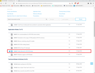

we consider using SPC57x or SPC58x for our products. I did find Safety Manuals for STM8 and STM32 but non for SPC5x. I know the chapter in the Reference Manuals with explanations of the CRC, STCU2 ... modules but I'm missing a complete list/table of neccessary safety mechanisms like in the STM32 Safety Manuals.
Were can I get the Safety Manuals for the SPC57x and SPC58x?

Hello ,
There are some useful applications in SPC570S documentation part (example)
https://www.st.com/en/automotive-microcontrollers/spc570s50e1.html#documentation
