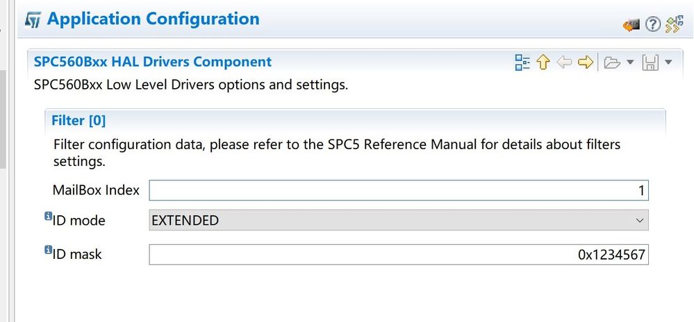

I can't find any document that defines the Filter and Mask for FlexCAN, so I post a question about it.
I think the filter only passes frames that contain exact ID as the ID in ID mask field. Am I right?
0693W000005BDKVQA4.jpgBest regards

YES you are right.
The CAN controller is configured to use the RX global mask that is set to 0x0FFFFFFF
