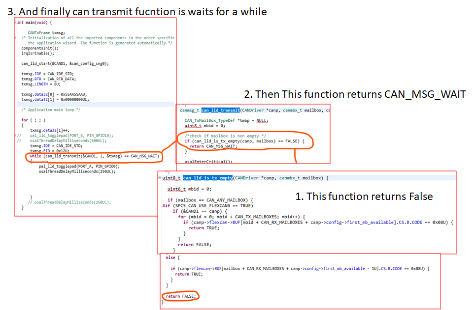

After i start the application the program gets stuck in the transmit while loop:
  1. while (can_lld_transmit(&CAND1,txmailbox, &txmsg)==CAN_MSG_WAIT){
  2. }�?�?�?�?�?�?
Its seems like that thecan_lld_is_tx_empty function returns FALSE and it breaks the can_lld_transmit function.

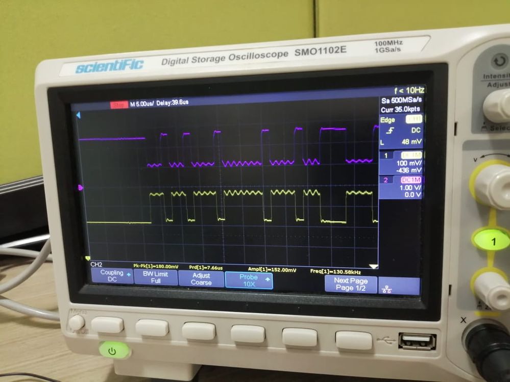

But to verify that code is correctly working or not with help of CRO, Meanwhile our team already done the same thing send a message through CAN using STM32 Controller but here we can see that in the code it self it stucked into the function then how it will transmit when we connected with another CAN transceiver
Kindly check the pictures for your reference0693W00000AMimhQAD.jpg0693W00000AMioOQAT.png

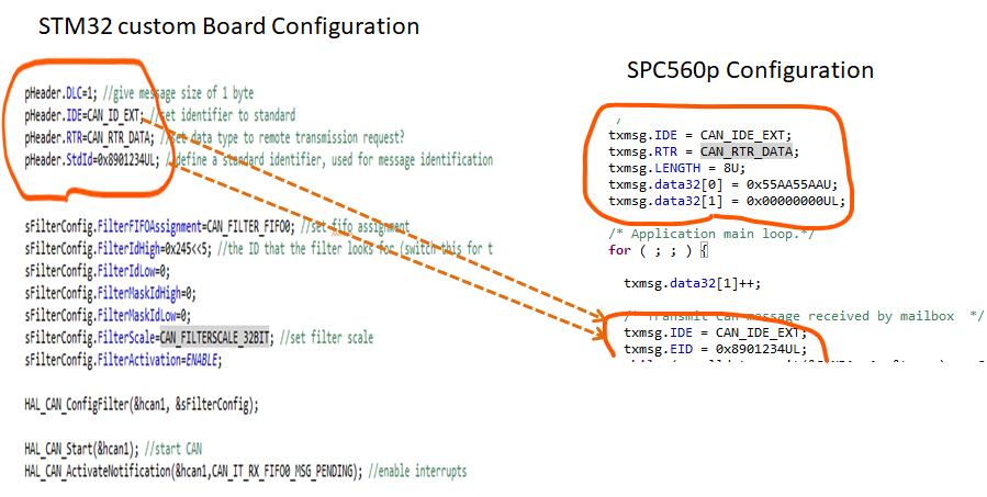

we have seen the Code which is same as our code only change we are using the Standard your code using as Extended but that not be issue right
Then we dumbed your code to the SPC560P Disc Board Same thing happened it not transmitting But this we are transmitting to another Board which having the Transceiver and it is working we already verified that one,
Now we doesn't understand what is the issue is how to solve this one

  3. Now the problem is Connected this two board the transmission is not happening same place code is stucked
zambrano.luigi
HI Saravan,
let me suggest to check the baudrate. It is mandotry to have the same baudrate on the 2 boards. Moreover, let me suggest to check also the endianess (ARM is little endian, PPC is big endian).
Regards,
Luigi
