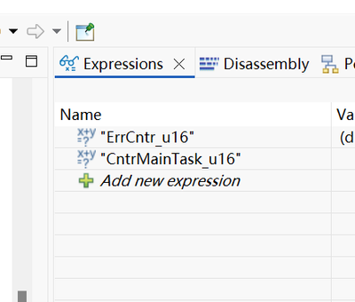

in Debug perspective, I can only find the Expression view, but cannot find the Live Expression view in "Window--show view".
With Expression view, the monitored variable will be refreshed only when pause the debug session,
if it has Live Expression view, I can watch the variable value without need to pause.
So I want to know if stellar studio have made the Live Expression function or similar functions now?

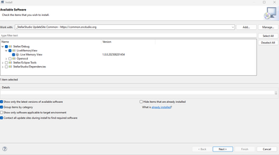

Hello ,
Yes , we have to install Live Memory View (cf screenshot)
Best Regards

2025-12-02 8:12 AM
Hello ,
Best Regards
Erwan

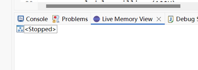

Hi
sorry for later response.
but from my practice, the live memory view below is not what I expected.
I cannot add variable into it.
The "live expression" view should be similar to "expression" view below, but still I cannot find it in Stellar Studio.
