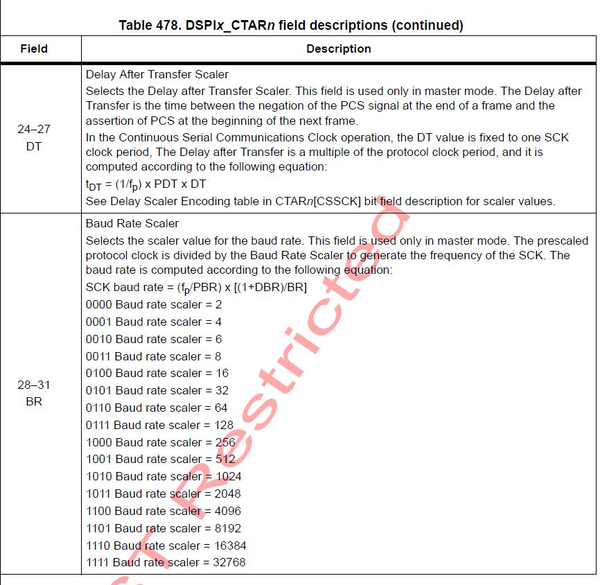

My Problem is, i divide the SPI Clock with:
AC0_DC3 = 0x80310000
According to the Reference Manual, the Spi Clock should be 400kHz (40Mhz Crystal / 50 / 2), but it's 200kHz.
Could anyone tell me where my issue could be ?

AC0_SC/AC1_SC/AC2_SC/AC3_SC is well set to external crystal simulator
the SPI clock should be
(40Mhz Crystal / 50) = 800kHz
Maybe i have missed something.
Did you check your CTAR configuration ?
Anyway, i am going to check with DSPI experts in Autosar team .
Best regards
Erwan

RM0349 Page 473 (Figure 160) say, that the Clock aips_clk1 is divided with 2. 400kHz should be correct.
BR, PBR and DBR are set to 0.
2017-08-21 4:53 AM
Hello David ,
aips_clk1 is not the good clock.
you have to take periph clock
Best regards
