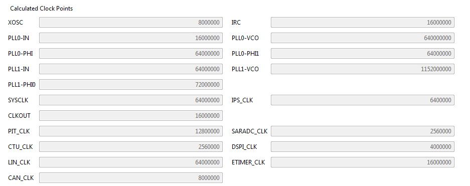

Hi, I amtrying to setup the clocks/PLL on the
SPC570S40E1 microcontroller.I would like use the PLL0 as the system clock.
Here is my configuration:
AC3 SC -> 16Mhz IRSOC
AC2 SC -> PLL1
PLL0 Settings:
PREDIV -> 2
MFD -> 80 RFDPHI -> 10 RFDPHI1 -> 10PLL1 Settings:
MFD ->18 RFDPHI ->8With the above settings, I get the following clkrates.
Here is my initialization code. Its getting stuck in the while loop waiting for PLL0 to lock. I am following the PLLs initializationprocedure that is recommended in the reference manual.
