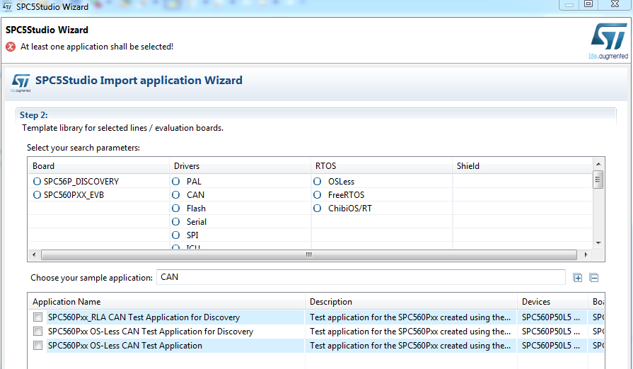

I'm having difficulty setting up an SPC560P50L project for CAN. The given example (OS-less CAN) seems to due internal loopback which is not very useful for my application. (pinouts arent even automatically set)

Are there any sample projects that transmit out out the board to an external node and receive from an external node?

Hello Bryan ,
There are some others example in AppWizard (RLA)
RLA means Register Level Access
In SPC5Studio , you can configure your CAN Driver (HAL or RLA)
In order to set you can use the Pinmap editor , the code will be automatically generated.
