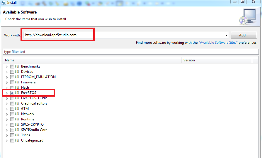

Hello ,
Sorry for the late answer
You can download the component by using the update site mecanism on http://download.spc5studio.com
the Demo application will be displayed on the Application Wizard
and you will be able to add the freertos component in your current application.
best regards
Erwan
