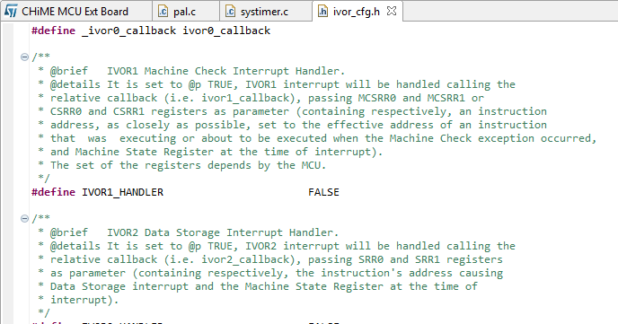

Hello Luigi,
As per ivor_cfg.h file, IVOR1 is for Machine Check Interrupt Handler. Please see the screenshot of the same.
So, as per my understanding, this ivor_cfg.h file is not having exception handler for NMI.
Please correct me if i am wrong.
Thanks for immediate response
2021-02-25 2:52 AM
NMI is managed by the Machine Check interrupt (IVOR1).
