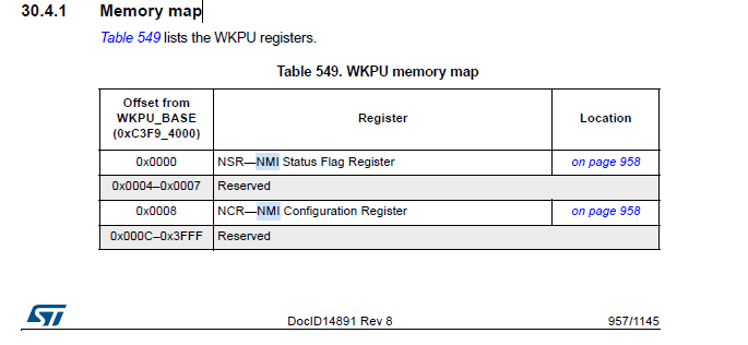

2021-02-19 6:18 AM
Hello Erwan,
Thanks for quick response,
I will try "SPC560Dxx_RLA WKPU API Test Application for Discovery " in SPC560P Disp.
But the SPC560P dISP is not having below registers as per reference manual (Attached the screenshot)
My quention is that , wakeup will support in SPC560P Disp?

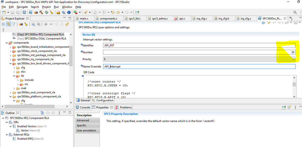

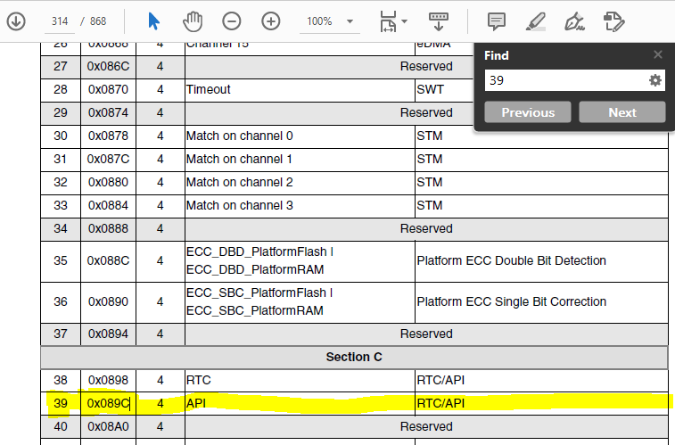

2021-02-22 5:10 AM
Hello Erwan,
For SPC560Dxx MCU, IRQ number for API is 39, i got this information from reference manual ( For the suggested example code "SPC560Dxx_RLA WKPU API Test Application for Discovery " ). Please see the yellow highlighted portion of the attached screenshot for reference.
Similarly, What is the number to be configured for NMI in SPC560P50L5? . This information is not available in Reference manual.
Kindly suggest your input for this.
2021-02-22 10:54 AM
Hello Erwan,
I got above information from datasheet.
Could you please let me know, which external source can cause Non-Maskable interrupt?
2021-02-24 11:41 PM
the RTC/API is not present in SPC560Pxx.
Regards,
Luigi
