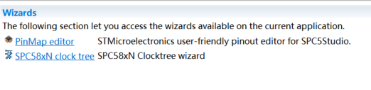

when i configure spc58nn project ,there is pineditor and clock tree ,the configurtion gui. and i cant find any other peripheral configuration gui,any one know this?

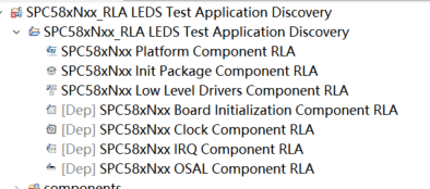

0693W00000SwJlOQAV.png0693W00000SwJlnQAF.pngi import example project,there are only two items above,and i want to know if there is any other peripheral wizard,such as canfd ,SDADC or GTM and so on.
ODOUV.1
There are no other Graphical tools.

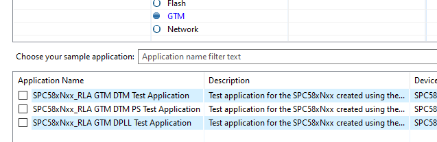

You can take a look at GTM examples:0693W00000SwK4uQAF.png
