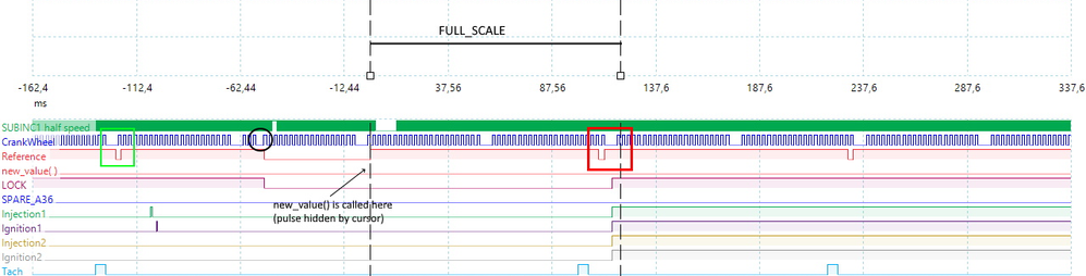

I am struggling to understand why the provided example seem not to behave as expected:
Is there anybody running into similar issues on this specific platform? How did you get over (if you did)?

The Test Application I am experimenting with (which ships with SPC5Studio) is largely based on them.
Once you'll have your SPC572L platform up and running, please post your success case of missing-tooth scenario and full resync procedure (it'll be interesting to see if injections/ignitions are preserved upon DPLL is locked again on the profile)

The example provided with SPC5Studio for the Discovery board can run with different flywheel confgurations. Here I am experimenting by simulating a 24-2 flywheel. The number of teeth is not the problem.

Ok, it looks like I'm the only one who struggled with this. So here is my solution (which came after quite some non-painless testing):
Hopefully this can be of use if you are confused about what is going on in the process.
