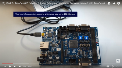

Dear Max Vizzini,
My board is AEK-MCU-C4MLIT1 and when I read the manual it said that the debugger works with the UDE PLS software. When I installed FTDI driver as you told me, I still face the same issue eventhough all the drivers and software are installed. In addition, I connect the board with my laptop using usb cable only and do I need to power the board with 12v DC all the time? because the part 7 of the ST's tutorial did not power the board with 12v adapter (the picture below).
Any help would be very much appreciated.
TH.
Yes, you need to power the 12V, the USB will not supply the microcontroller.
Best Regards,
AutoDevKit Team
