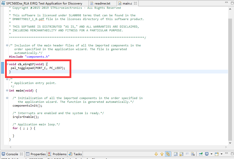

I looked at the routine of SPC582B60E1! In the routine, pressing a button can use the callback function that interrupts the button to light up the LED light, but I have a question: how can I turn off the already lit LED light when I release the button? Can you give me some ideas or routines? I want to learn them! This is very important to me, thank you all big shots!

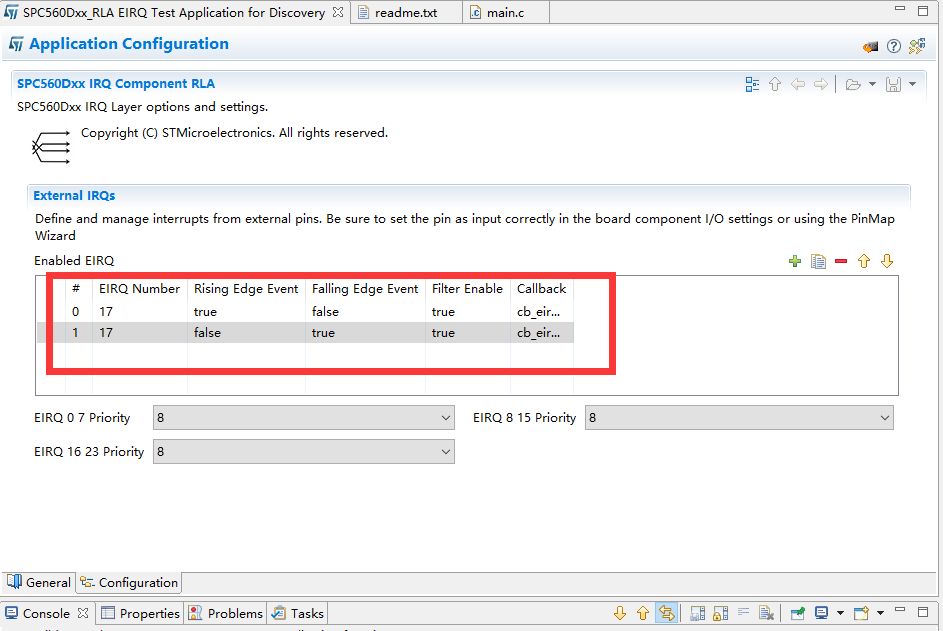

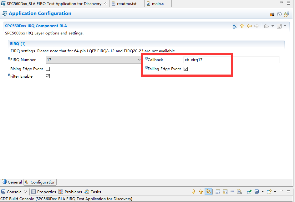

Hello! I have defined two interrupts in the external interrupt EIRQ17, namely the rising edge interrupt and the falling edge interrupt! As shown in the following picture! Is this definition acceptable? Also, can the name of this Callback only be written as cb_eirq17? If that's the case, then if I define the callback functions for the rising and falling edges as having the same name, will the program execute incorrectly due to the same callback function name during execution?

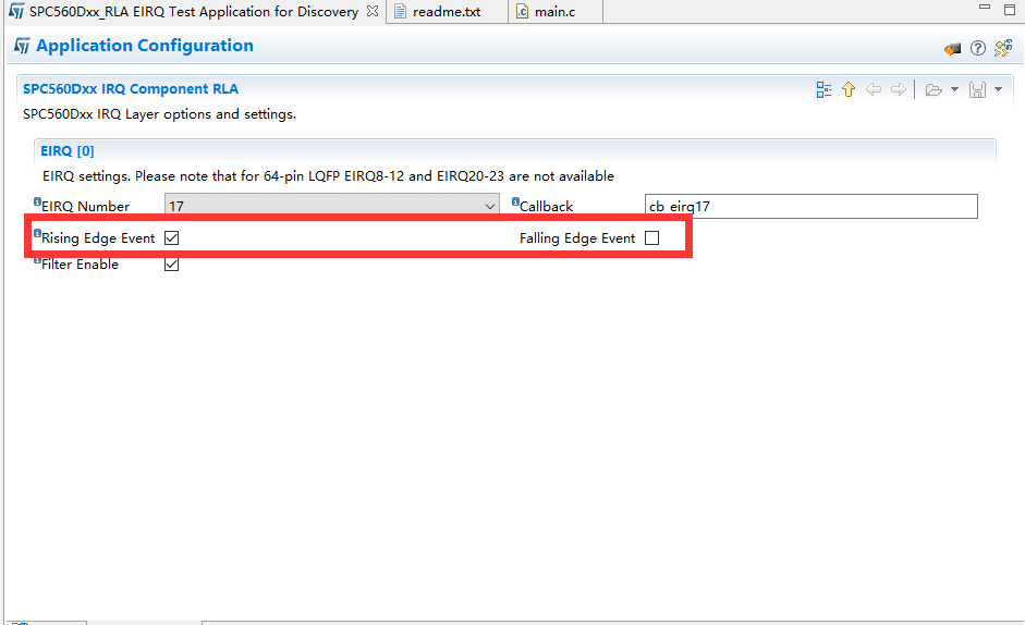

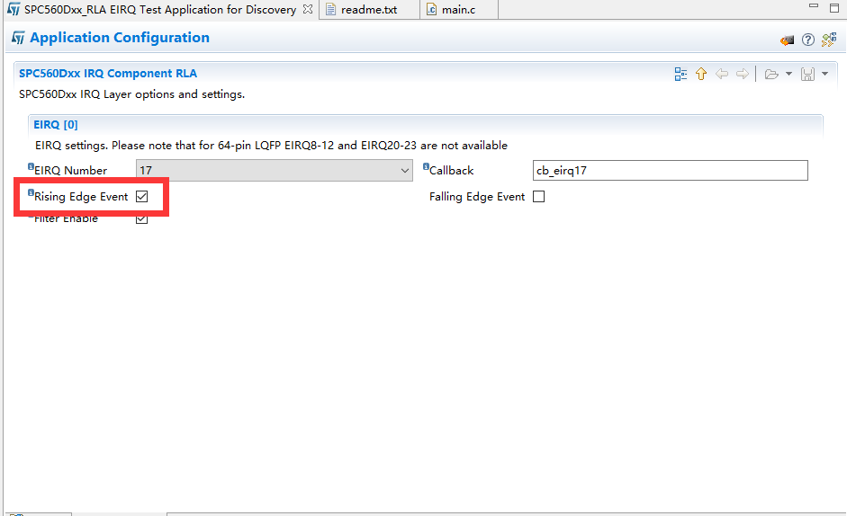

Hello! I have found the interrupt option to set both the rising and falling edges simultaneously! As shown in the following picture! But how can I write the callback function in the program to turn on the LED light on the rising edge and turn off the LED light on the falling edge? Can we add another interrupt setting with the same interrupt number and then write a callback function with a falling edge to execute the LED light off! Hope to receive your guidance! Thank you!
