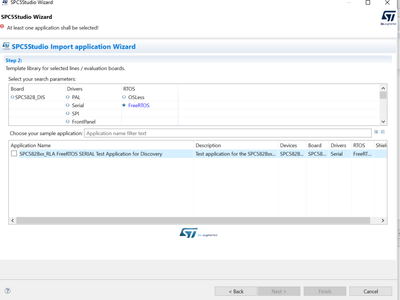

Now I am facing one more issue, I took FreeRtos example(as shown in the snippet) as the base source code and integrated AEK-AUD-D903V1 RLA component. After integration, "AEK_903D_Init(AEK_AUD_D903V1_DEV0)" API is not getting initialized. The execution is getting stucked inside this API.
Can you please help me to come out of this issue, so that I can integrate FreeRtos and amplifiers together.

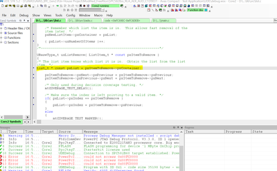

I have modified the code as you insisted but the execution is getting stuck inside vTaskDelay and vTaskDelayUntil.
Attached snippet shows the line where the execution is actually getting stuck.
Can you please help me to come out of this issue.
2024-04-22 6:48 AM
The code you show is part of the freeRTOS driver.
The memory error location is the Flash.
Probably when you loaded the new sound files (wavefiles) you changed the memory structure and location therefore now the code is not working anymore.
Once again, moving the code from the existing version to freeRTOS is not an easy task we can support by community posts.
Thank you in advance for your understanding.

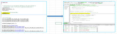

1. If I use vTaskDelay() or vTaskDelayUntil (), Execution is getting stuck at "List_t * const pxList = pxItemToRemove->pxContainer;" line in uxListRemove() API(As shown in the snippet).

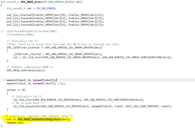

2. If I comment vTaskDelay() or vTaskDelayUntil (), then execution is getting stuck at "ret |= AEK_903D_SetDefaultRegisters(dev);" line in AEK_903D_Init() API(As shown in the snippet).
2024-04-23 2:18 AM
You are calling a vTaskDelay() primitive without creating a task and without starting the scheduler?
If so, no surprise the task handler does not find any active task...
You CANNOT just add freeRTOS components and some primitives and hope everything works: you need to CHANGE the ENTIRE code to run under an operating system.

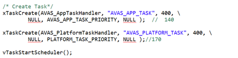

2024-04-29 3:02 AM
Hi Max VIZZINI,
A very good afternoon, Thank you for your informative response and guidance.
Actually I have created two tasks with different priorities(as shown in the snippet) along with the task scheduler.
But still execution is stuck inside delay function.
Can you help me to come out of this issue
