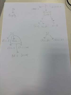

hi i want to monitorate just the voltage of 4 cells. this is the schematic, it's correct?
Connector J4 -> empty
Connector J3 -> CAN1_L/ CAN1_H for can communication
POSITIVE POWER SUPPLY -> KL_15/KL_30
NEGATIVE POWER SUPPLY-> KL_31
Connector J5 -> CELL_1 CELL_2
CELL_0/CELL_GND connected to negative of shunt resistor
Connector J6 -> CELL_14 and CELL_13
It's everything okay?
