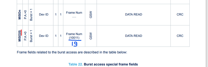

Hi Max,
In L9963E data sheet, in Table 21 MISO2 where frame no. is 2 (0b10), is this referring to burst response frame no. 1 in Table 24, 25, 26 ?
The answer is Yes.
Best Regards,
AutoDevKit Team

Hi Max,
seems it is a documentation error.
with regards,
bitBuddy

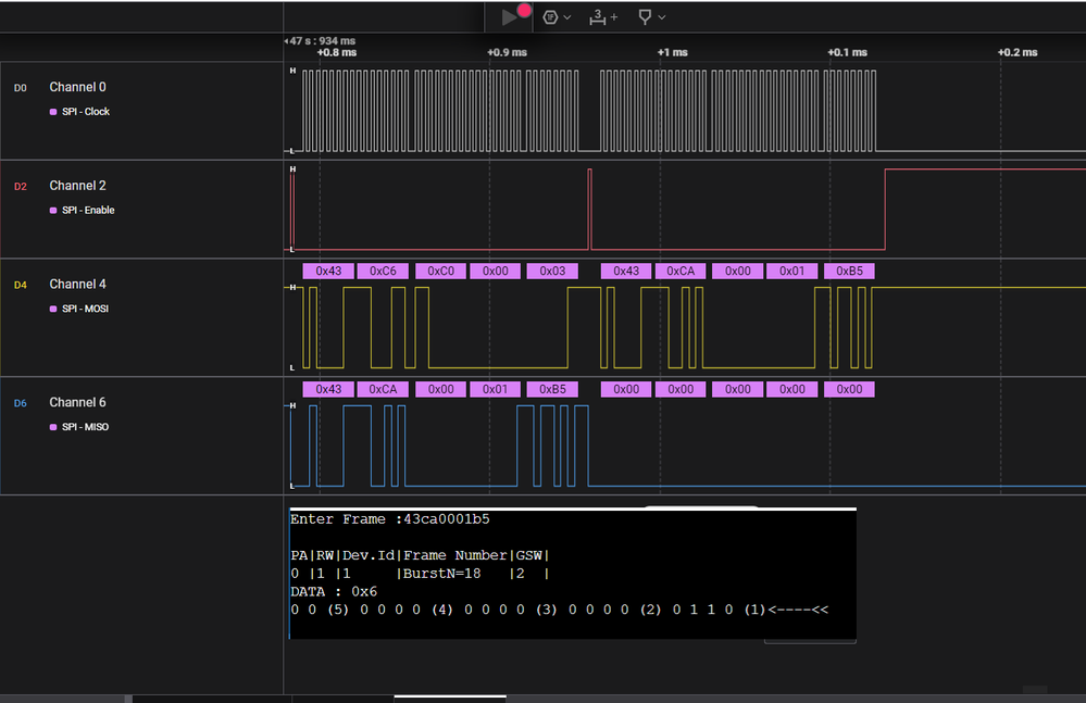

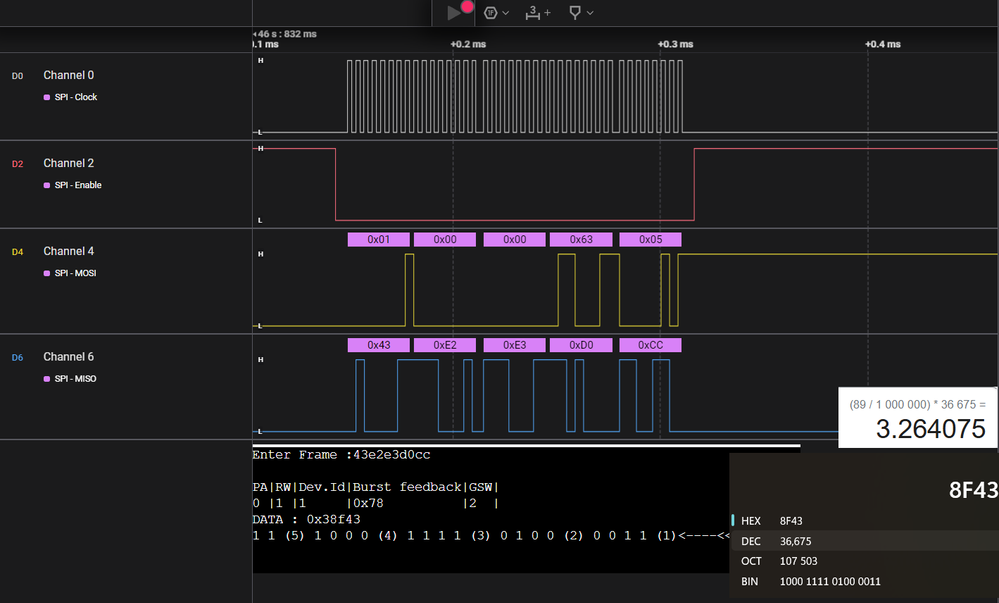

As per observation in logic analyser, in burst(0x78) command feedback frame(MISO1 in table 21), data field is for frame 1 of Table.24 and burst response frame MISO2(in table 21) where frame no. is 2 (0b10) referring to frame 2 of table 24.
Hence we get max of 18 frame (MISO18 : Frame Num-18 (10010) in table 21) .
Regards,
bitBuddy
