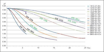

In short, capacitance is a function of voltage. At 0V, the capacitance is the rated value, but it drops as the capacitor becomes charged. This effect is stronger for smaller capacitor packages. This means that your sinusoidal input will not be symmetric, even with large caps, but the effect is stronger as you move to smaller sizes.
Here's a good graph that shows the effect along with the effect of smaller packages:
Using larger caps and/or ones with larger voltage ratings is one solution. Another would be to have your input be symmetric about V=0 and bias it afterwards.
