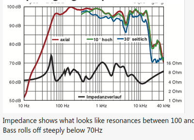

About the La Scala II : (i dont have them) but from (private) reviews :
What's missing: Real deep bass.So dont think, you will improve anything, by lowering the input filter cutoff (-1dB / 20Hz , with the 0,56uF /22k).
see La Scala response (typical for a horn speaker):
So at 30 or 20 Hz this speaker producing no sound pressure and its totally waste of energy, to give more subsonic sound to these speakers.
IF you want to gain the bass, add some gain in the 60..120Hz range; THIS you will hear and it will make the speaker sounding more "big" and fat/impressive.
With a horn speaker , giving more subsonics to the speaker, you will in best case (!) change nothing on the sound, usually it will sound more bad or "thin" .
