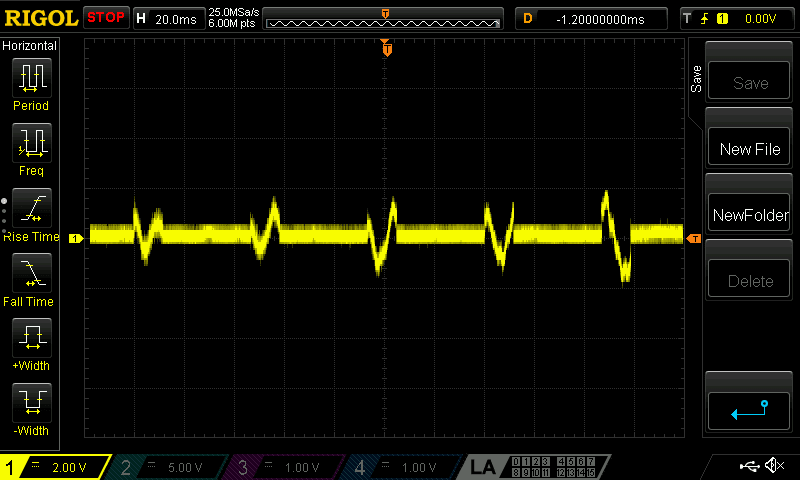

Sound is deformed and too slow.

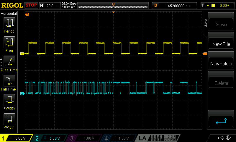

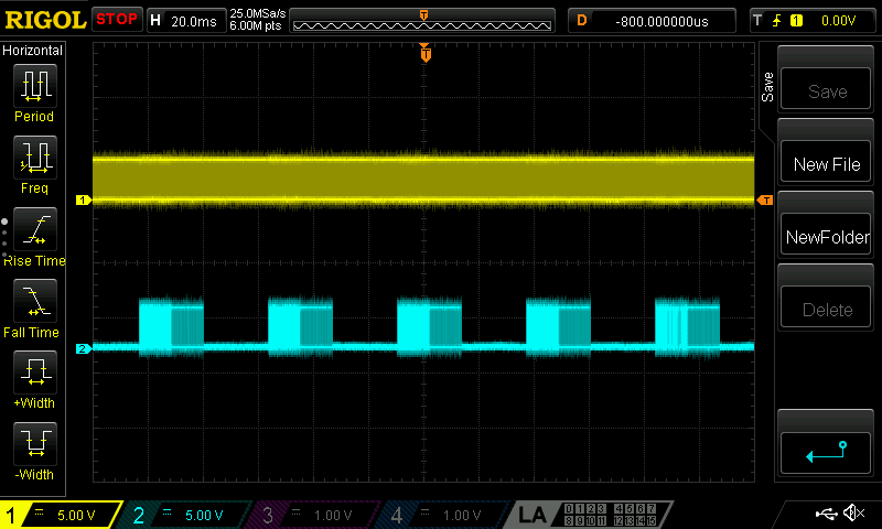

When I connect oscilloscope I can see that audio signal is generated only in 1/3 time.
When I checked LRCK i SDATA signals - reason is clear.

2023-04-28 5:09 PM
I'd probably opt for a larger buffer, and align the data reads
The header read will knock it out of alignment, so perhaps you can just zero it out, or figuring out a different buffering scheme.
Benchmark the reads, make sure you have the bandwidth.
Check I2S with a sinewave you generate.
2023-05-01 2:57 AM
Thank you for suggesions. Debugging with sinewave was helpfull :)
Finally I founded 2 problems:
1) I have int16_t type buffer (2 bytes), but function f_read need amount of data to read in bytes. When I sended AUDIO_BUFFER_SIZE / 2 it read only 1/4 buffer. I change it to AUDIO_BUFFER_SIZE to fill half buffer.
2) I change sampling frequency of file and I2S configuration to 22kHz.
After that sound is playing without deforming and at the right speed.
