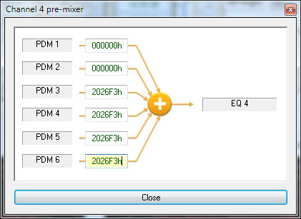

In order to downmix the 4 mic of STEVAL-MKI129Vx board into a mono stream you can use the embedded processing features of the STA321MP onboard device. Simply set the pre-mixer coefficients for the ''Mix In 4'' and ''Mix In 5'' to the corresponding hex value for -12dB (ie. 2026F3h instead of the default 7FFFFFh value), this for the PDM3/4/5/6 inputs . Refer to the below picture.2014-10-21 7:03 AM

thanks for your fast response.I followed your instructions but i can make mic 4 and 5 working but not the 3 and 6.Here's my config file. Could you please review it?https://dl.dropboxusercontent.com/u/28754179/3456in1.apc.zipToday i have a recording session and i need to solve:- record a voice in mono adding mic 3 4 5 6 of the array to get the best SNR.- record in 24bit.I'm currently using Audacity but it exports in 16bit.I've tried Adobe Audition but it gives me an error ''Input and Output sample rate are different. Cannot record''I've select all the sample rates available on Audition and on APWorkbench without success.Could you please give me the solution to this two issue i have?Thanks so muchReally appreciated.My email is baggiomichele@hotmail.com to contact me directly.2014-11-12 3:45 AM

If you're going to use the digital upstream via USB (instead of the HP output) then you should replicate the coefficients I suggested in my previous post on the CH1/CH2 pre-mixer controls. Jsut to be clear: the headphone jack gets the output from CH4/CH5 of STA321MP whereas the digital upstreaming is done from CH1/CH2. MarcoWe’re moving the ST Community to a new platform to give you a better and more reliable community experience.
