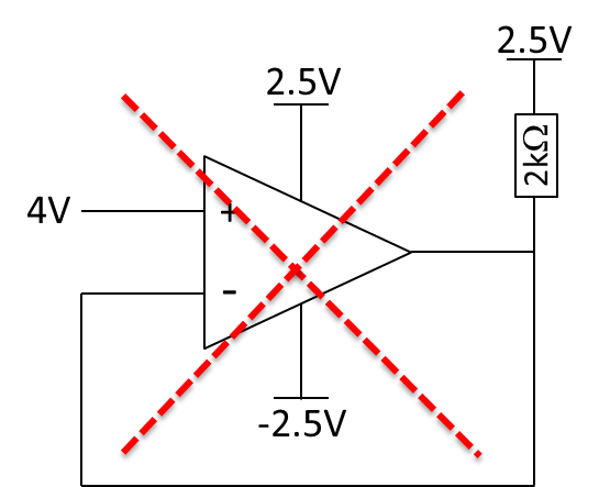

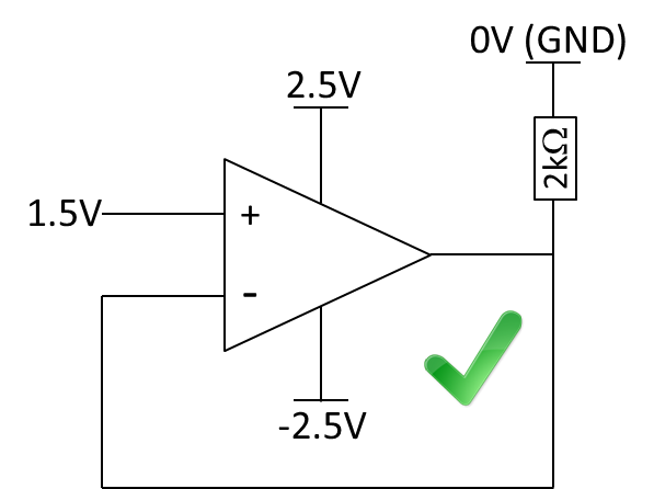

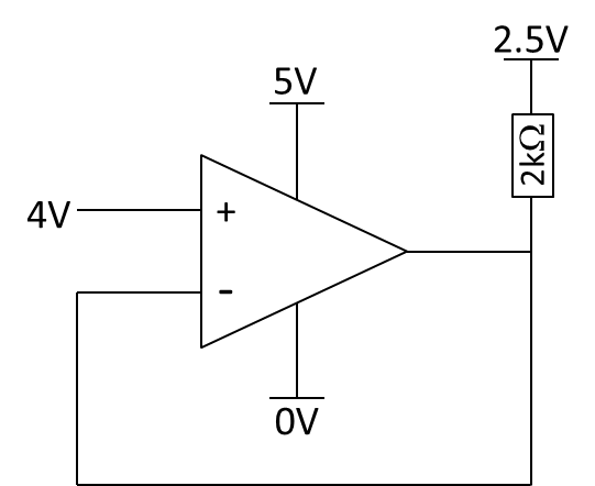

Perhaps, you wonder what is the difference between single and dual supplies ?Or maybe if the op-amp will have the same behavior with Vcc= 0 -> 5V or Vcc= +/- 2.5V.It is important to keep in mind that all voltages have a reference. It means that we have to think : difference of potential.Most of the time, when we say Vcc=5V, it means a potential difference of 5V referenced to the GND : 0V.As a conclusion, we can deduce that both of the following configuration will have the same behavior :We’re moving the ST Community to a new platform to give you a better and more reliable community experience.
