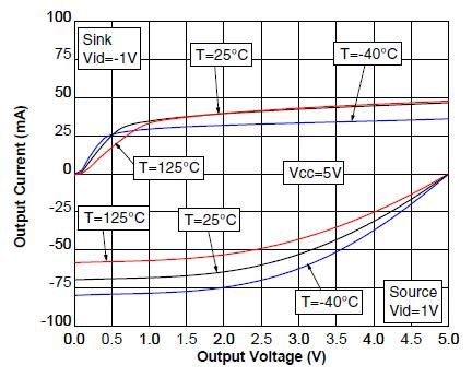

In datasheet, sometimes maximum output current is indicated (IsourceMin, Typ, Max), sometimes it is missing.What is the best method to determine if an OpAmp can supply enough current to our load?Thanks for the support,Jean #maximum-isink-isource #maximum-output-current #isource2012-05-07 6:08 AM
Dear Jean,
In most of datasheets, it is possible to find this information in the figures.For example, here below there is the figure 6 of the TSV851 datasheet. It shows the output current vs the output voltage.We’re moving the ST Community to a new platform to give you a better and more reliable community experience.
