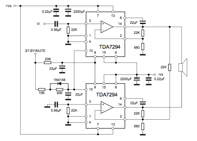

I copied this TDA7294 bridge circuit from the manuall:

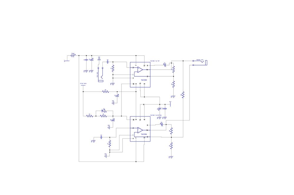

To this schematic:
I have checked and double checked the schematic and it seems accurate to the manual's circuit. All parts are correct values to the manual's circuit. The PCB board is correct to the schematic that I made. All solder joints are done well without bridging.
I am powering it with an 18V, 300mA power supply.

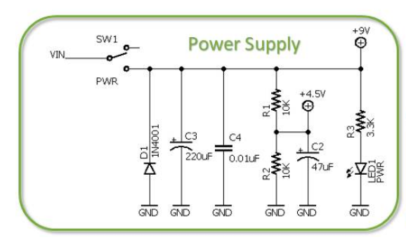

I am using this power filtering circuit in to the power bridge amp's power circuit (substitute 18V for 9V).
I am running it in to a 16ohm speaker load.
The application is to test guitar pedal overdrive circuits.
I am getting no sound and I can not figure out why.
Based on this information, does anyone have any theories as to why? Based on the chip's specs, it should be able to be powered with 18V.
Any help would be appreciated.
Thank you!
