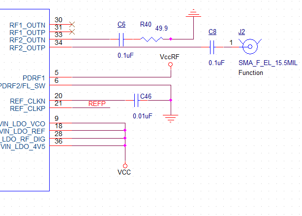

Thank you very much for your quick reply. I have few more questions. I would like to use STuW81300 to generate 14GHz signal. Based on my understanding, we should power down RF1 stage and power RF2 stage. Please see following Schematic:
Could you review the above Schematic? Can we leave RF1_OUTN and RF1_OUTP open when we do not use them? Should we connect 3.3V to PDRF1 to power down RF1 output and PDRF2 to GND to power up the RF2?

Yes, leave RF1_OUTN and RF1_OUTP open when unused.
Yes, PD_RF1 and PD_RF2 can be connected this way if you do not use the alternative and enable/disable the outputs by software. Please pay attention to this:
