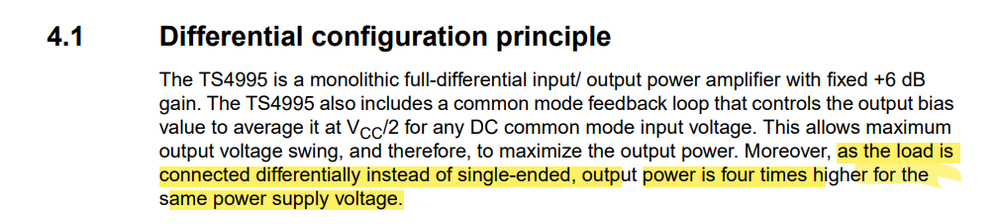

No at a time one load only i will connect but in your answer and shared part numbers i didn't get the info regarding how to get single ended output , only given like below

In datasheet only referring how it will be incase of single ended output
Not mentioning it will work for single ended outputs correct me if am wrong
