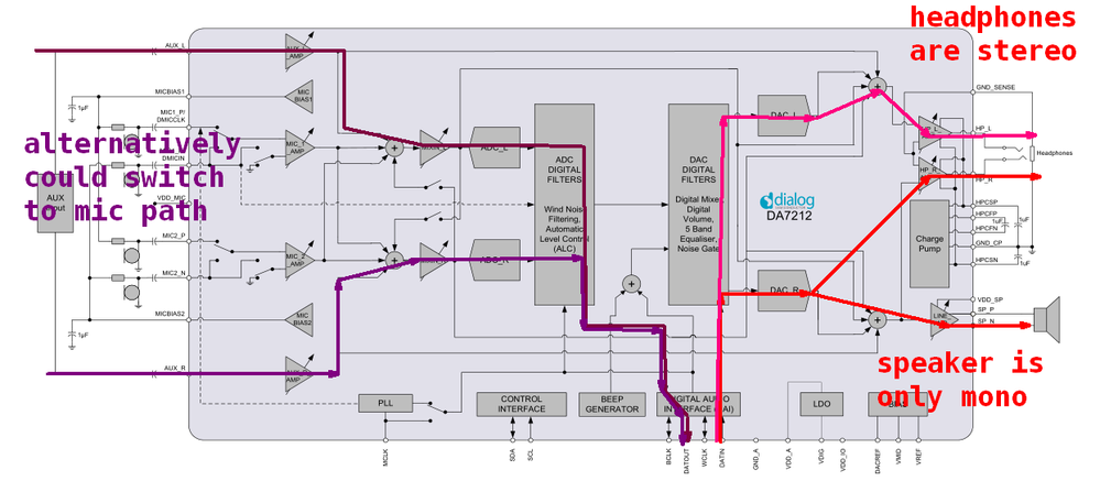

My customer wants to use a codec like this one based on Renesas DA7212.
Both to produce sound and receive & encode aux input (or a mic, not sure yet), simultaneously.
The chip has only one digital interface (plus I2C config i/f).
From the data sheet I cannot figure whether it can do this. The Renesas support is not quick to answer.

Yes, it can.
For that DA7212 the I2S clocks are:
BCLK = bit clock for serial interface, with f = 2 * bit resolution * sample rate
WCLK = sample rate
Check if that one needs a MCLK = master clock, which usually drives the sigma-delta sampling.
I prefer the names "SCLK" (serial) and "LRCK" (left-right, because when WCLK = 1 left channel is transferred, right when 0).
The codecs and the MCU interfaces are made for this purpose.
I'm working on that for some time now, and my experience with F767 and H723/H735 is that the SAIs are easier to synchronize, because you can "wire" the clocks internally, compared to the I2S interfaces (or have I overseen anything).
So take a SAI which is made up of 2 sub-parts called blocks.
Set one block as master, the other one as slave to "SAI within same block" or so.
Then you only use the clock GPIOs from the master + master's data + slave's data.
One problem you might encounter:
Most STM32 have a fixed oversampling rate (256?), which is MCLK / WCLK.
That s***s...
But you can work around that by using another I2S and use it only as MCLK.
