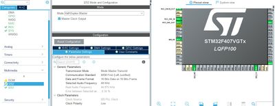

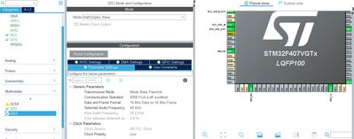

2024-01-21 10:36 PM
There is no option to synchronize wck and bck in CubeMX, do i have to connect them externally between I2S1 MASTER and I2S2 SLAVE Transmitters????
2024-01-21 11:32 PM
Right, if there is no internal connection to select, you have to connect wck and bck externally .
