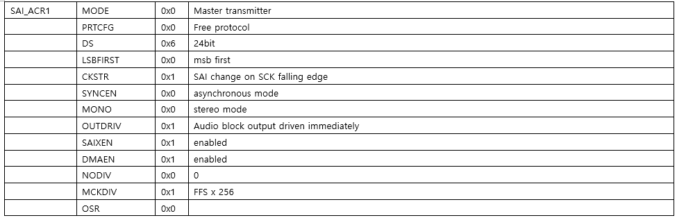

And, this is my SAI_A setting.

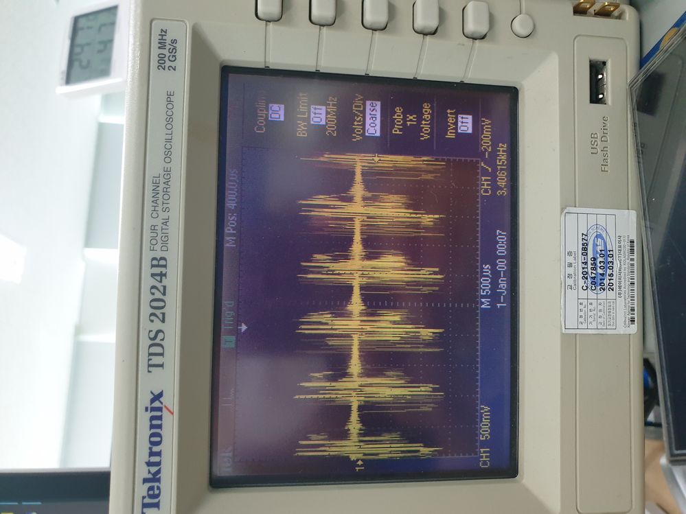

This is my output waveform.

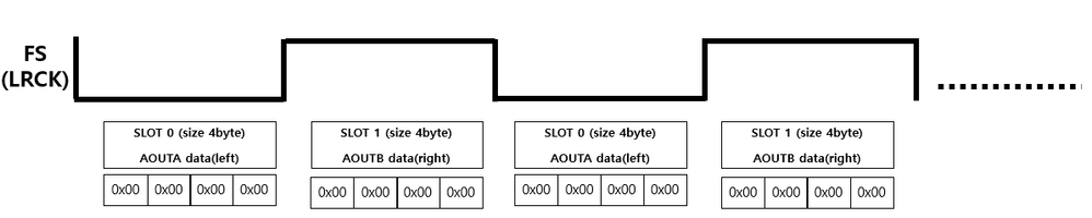

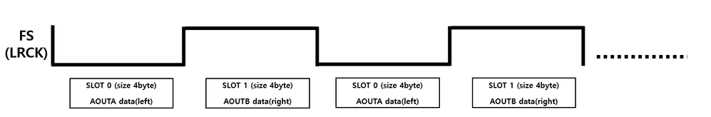

I thought that if I filled the buffer with 4 bytes of data and sent it to dma, it would be as below.But, I got noise waveform.

I attached my CS42L51 register setting.

2022-04-25 8:19 PM
I attach more pictures.
I send input buffer data to output buffer.(100Hz 100mVpp sine wave from function generator)

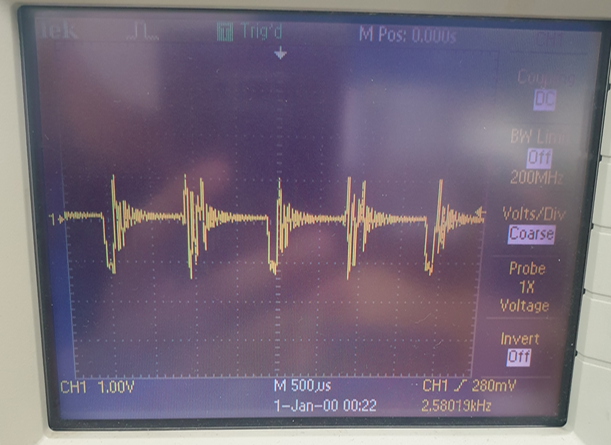

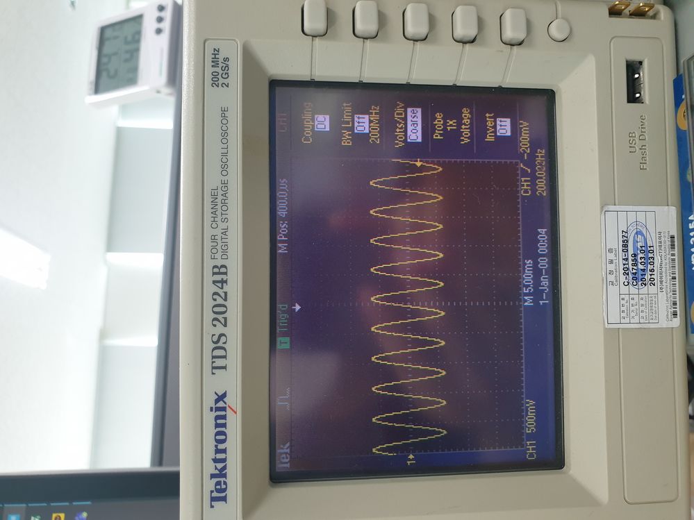

when i set frame size to 16bit,
the waveform is clear.
This is 24bit frame size.
2022-04-26 2:05 AM
The problem has been resolved.
I missed below code.
HAL_SAI_Receive_DMA(&haudio_in_sai, (uint8_t*) pBuf, (uint16_t) (NbrOfBytes / (Audio_In_Ctx[Instance].BitsPerSample / 8U)))My Audio_in_Ctx[Instance].BitPerSample was 24.
I modified this value to 32.
