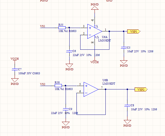

目�?�?用的LM358芯片,�?�电压跟�?器,出现输入电压V+为0V时输出电压有�??几�?
QLiu.2
Associate
现在有一个项目上用了LM358�?放,�?�电压跟�?器用,用在电机上的,现在出现的问题如下:358是15V供电
�?�了一百多�?��?��?,有差�?多五六个出现了下述情况,�?良的芯片输入电压V+为0V时输出电压有�??几�?,�?良的芯片正常工作时,输出电压�?�是正常的,�?�是输入电压是多少输出电压就是多少。
项目比较急,麻烦尽快帮分�?下原因​
原�?�图如下:

The outputs of the LM358 directly drive a 10µF capacitor, which is definitely too much and can lead to oscillations or, as in your case, to a latch-up. A latch-up can usually be reset by a power-on reset, but can occur again if the cause is not resolved.
Please consider to insert a resistor of e.g. 820 ohms (min 470 ohms) between the output of the LM358 and C5/C8 if you need some kind of a low pass filter.
