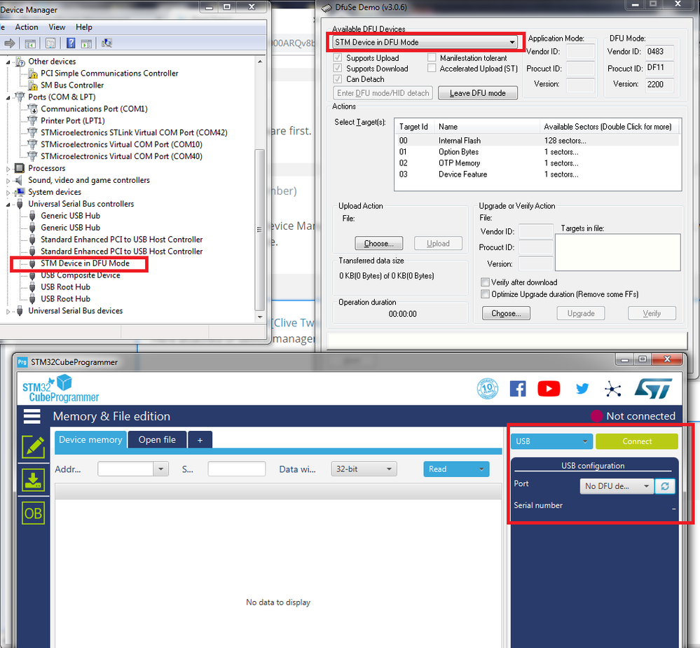

Here I attached a snap of device manager, Cube programmer and DFU-SE demo.

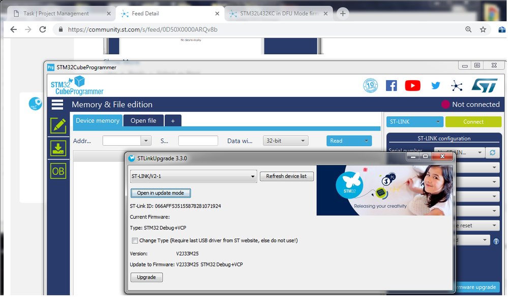

My device has been detected as STLINK mode but not as DFU mode after before and after upgrading Cube programmer and Device firmware software. I attached a snap of my device firmware version hereby,
