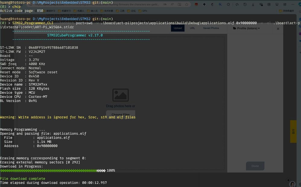

Hello @totoro
I don't think this is a bug since STM32_Programmer_CLI is normally used in cmd shell on Windows or Terminals on MAC or Linux (With the default encoding (IBM850), the progress bar is displayed as expected).
Could you specify what you're using exactly ?
As I see it, this is most certainly a Terminal encoding issue. Could you try the following :
>chcp 850
Let me know if it solves the issue,
Aziz

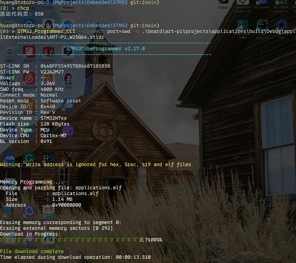

2024-10-23 7:35 PM
Sorry, I forgot to reply, this method cannot solve that problem.

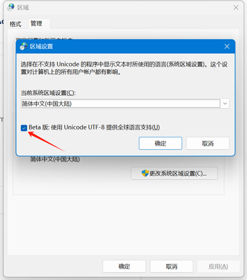

2024-10-24 1:14 AM
I think I understand. It may be related to one of my settings.
2024-10-24 1:40 AM
So what happens if you change that?
2024-10-25 7:01 AM
It still does not display the progress bar's graphic characters correctly, but the result is different from before.
