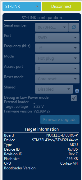

I'm using ST Link V2 4-wire debugger to flash my board (self designed). I noticed that, if I lower down the "Frequency", then it can sometimes successfully flash (in this screenshot the frequnecy is only 15kHz).
When I select higher frequency, i got error like "Error: ST-LINK error (DEV_TARGET_CMD_ERR)".
When I select even higher frequency like 4000kHz then it can not connect at all and shows "Error: No STM32 target found!"
Therefore I would assume that the "write protection" error is a fake error, which is caused by disturbed signals between my board and the debugger.
Do you have any extra comments please? E.g. do we have any guides or application note about the 4 wire SWD debug port design?
