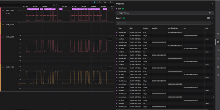

Thanks for your answer Eben,
We've followed all instructions as you attached above and are able to observe CAN frame signals as below. But still we see BRG_CANERR message on STM32CubeProgrammer. So I am wondering if there is no workable CAN bootloader code in ROM or we need to send rst signal to STM chip (STM32L562) from STM32CubeProgrammer.

Hello Amie,
Still we're encountering issues for CAN bootloader. After applying RESET to STM chip (STM32L562CE) from ST-Link V3SET board. Now we see BRG_TARGET_CMD_TIMEOUT message on STM32CubeProgrammer. Just in case we've tested CAN bootloader using L452RE evaluation board and ST-Link V3SET, it works fine. So I am wondering if there is no workable CAN bootloader code in ROM of L562CE chip. Or additionally we need to setup STM chip (STM32L562CE) board. We've used pattern 12 for L562xx Bootloader configuration as suggested in AN2606.
