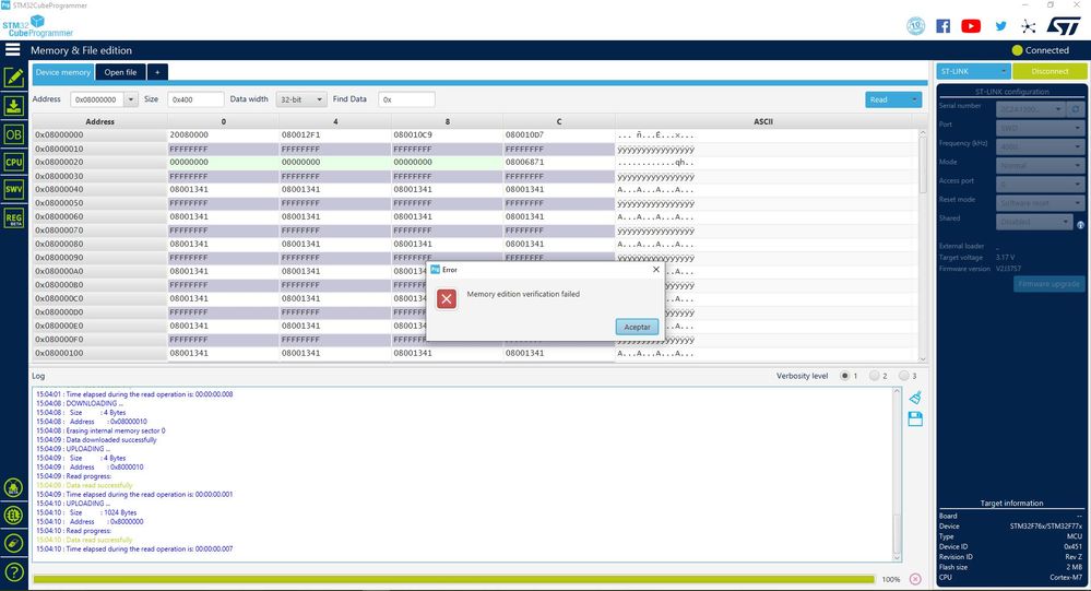

We are having problems with one of our STM32F767 when we try to write on odd 16 Byte aligned internal flash memory.
The screenshot is from after programming a well-known binary (that works on other MCUs) and reading from 0x08000000 address. We see periodically all 0xFFFFFFFF. We cannot change those 0xFFFFFFFF, the STM32CubeProgrammer give us a error popup with: "Memory edition verification failed".
It is important to mention that finalizing, the programming of the well-known binary, the STM32CubeProgrammer shows a warning popup with: "Warning: The core is locked up".
All "Option bytes" was verified and are equal to other STM32F767 that works correctly.
What could be the cause of such behavior?
Thank you
